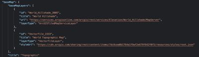

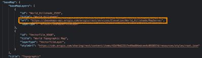

@cindy647 -- Looks like there's an odd URL being used for one of your basemap layers. I've never seen that before and don't know how it happened, but can you try this...
  1. Change to another basemap
  2. Save the web map
  3. Switch back to the topo basemap
  4. Save again
Here's what is referenced in your map...
Screen Shot 2021-04-22 at 5.25.20 PM.jpgScreen Shot 2021-04-22 at 5.25.20 PM.jpg
Here's what it should look like...
Screen Shot 2021-04-22 at 5.24.40 PM.jpgScreen Shot 2021-04-22 at 5.24.40 PM.jpg

cindy647
so bizzare.  thank you very much and i will give this a try.
cindy647
I followed the 4 steps above, but it still is requiring a login.  I also then went ahead and changed to open street map grey canvas and saved the webmap that way, but it still is asking for a login.
