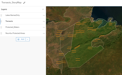

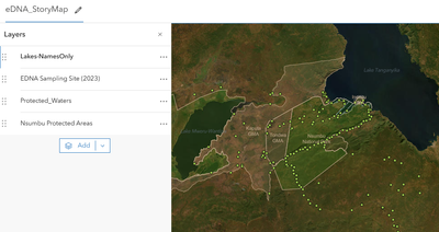

Thank you.  Yes sure here is the link, iPhones struggle just after the UNDERSTAND section, as soon as any of the side cars with maps load. https://storymaps.arcgis.com/stories/eb1b66cce8894955bc2a6028b1d73fae.
I attach screenshots of each of the transect and eDNA maps causing the current issues below that section
there really is hardly any data in there, and very simple symbology.
I have just gone through and replaced some of the maps with stand-alone graphics in the side cars to circumnavigate some of the issues (which isnt ideal, but helps).  I did also discover that the line layer that was published from Pro, performs better with new symbology native to webmaps (not the double line symbol that came from Pro) and I'm busy trying to replace all symbology from Pro with native webmap ones (including lables).
