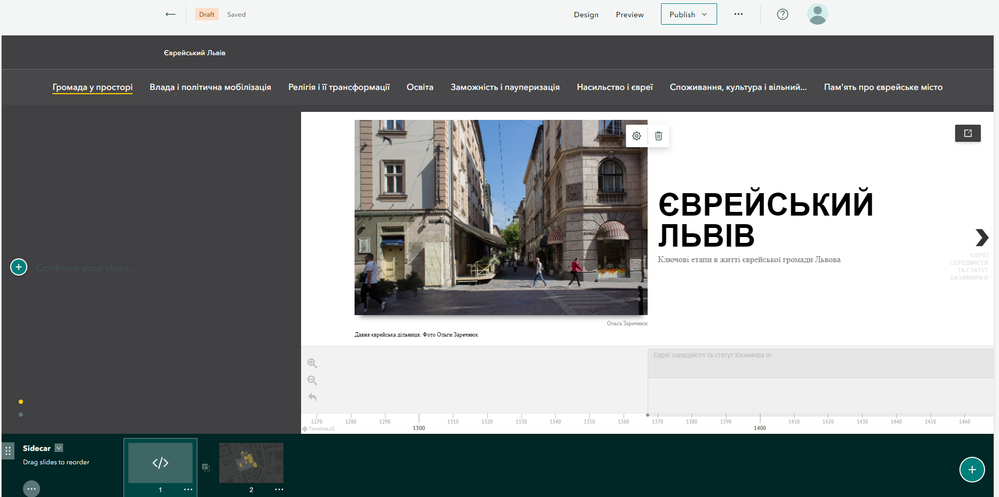

Since I've tried to embed the same Timeline link within a sidecar container, it appeared in a wider frame:
492bcda6c9e2cdd062997d3a6243229f
Wouldn't that mean that resizing option for their CDN isn't blocked by this external service? It would be a much easier option (not so sustainable though) to use their CDN than host an entire JS code on our servers.

It's not that the timeline is blocked from being displayed wider, it's that the response from the 3rd party service doesn't communicate that it can be resized, and that information is used to determine which configuration/sizing options to show for the inline block.
The timeline is simply expanding to fill the container size in both of those cases, it's just that sidecars and slideshow media panels always fill their allocated screen area and don't have discrete sizing options like the inline embed block.
I didn't think of that as a workaround, but that's a good idea to use a single-slide slideshow or sidecar block if that comes close to the experience you are looking for.
