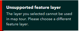

I'm not finding an explanation for what criteria determines whether or not a feature layer can be used in the Map Tour. Currently, I haven't been able to generate a feature layer that works with it. I keep getting the following error:
I have read the Add map tours page on Esri, but it doesn't tell me anything about the feature layer other than it needs to be a point layer (mine is) with at least one point in it (mine has 11).
I'd appreciate some guidance here, as I really don't want to upload each point individually. Thanks so much!

@BethanyLamb It looks like you are using an Enterprise-hosted feature service in an ArcGIS Online-hosted StoryMap. This is not a supported configuration. The feature service and story should be hosted in the same environment—either both in ArcGIS Online or both in an 10.9.1 Enterprise deployment. I suppose it's possible that a 10.9.1 feature service might work in an Online-hosted story, but that is not a configuration that we test or certify at this time.
Are you able to host your feature service in ArcGIS Online for this project since you are already using the Online version of ArcGIS StoryMaps?

@BethanyLamb -- Looks like your feature service is hosted on an ArcGIS Enterprise server running v8.2. To be supported in a map tour, a feature service must be hosted on ArcGIS Online or a version of Enterprise that supports map tours created using feature services, which includes 10.9.1 or later.
