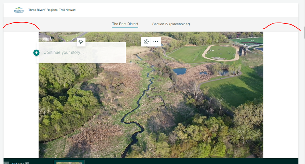

I was able to test what you sent me and the autoplay looks great! Side question- do you know if iFrame width/height are supported in the Sidecar Floating Panel? When modifying the height/width I'm still seeing white borders  along the sides and the video doesn't fill the screen:
Thanks again 🙂
OwenGeo
Esri Notable Contributor
We don't have as many options for linked videos as we do for uploaded videos because linked videos are a little more difficult for us to work with since they are coming from 3rd party services. Linked videos are currently always sized to fit to the media panel space (so you'll always see those bars).
Upload videos fill the media panel (and you can autoplay them). For now, uploading would be your only option if you want that experience.
