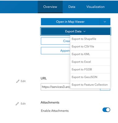

@povilasid -- If you used ArcGIS StoryMaps to create your map tour story, you can use the Print option (in the ... menu in the header) to export the story as a PDF.
The classic Map Tour template doesn't have a print option, but you can export the data from the feature service as @DavidPike mentioned. Just go to the item page for the feature service (not the story map), and you'll see an Export Data option there.
