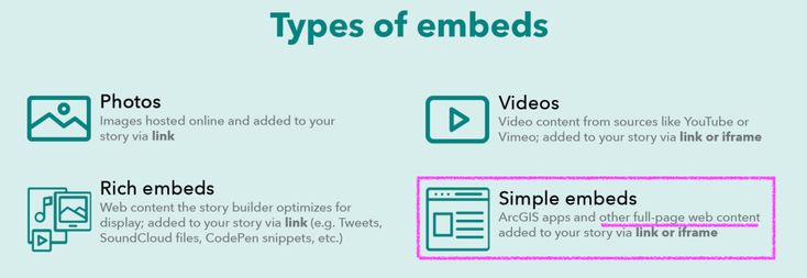

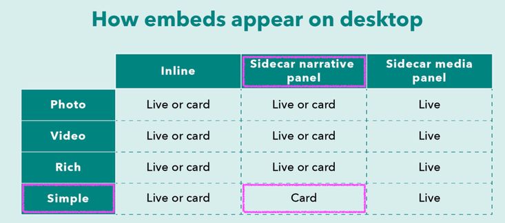

@DrPala -- I apologize that this isn't what you were expecting. However, that article you referenced does describe this restriction (see screenshots, below). The surveys are considered "simple" embeds and the table indicates they display as cards in sidecar narrative panels.
1. Survey123 forms qualify as "simple" embeds, so they also currently display as cards in sidecar narrative panels. Note again that you can add either type of survey inline in the main part of the story and show them as live embeds.
2. I'm not sure what tool you are using to make copies of the classic story, but if you use the new ArcGIS Assistant, you should be able to edit the copies. There is nothing about their retirement that should affect that.

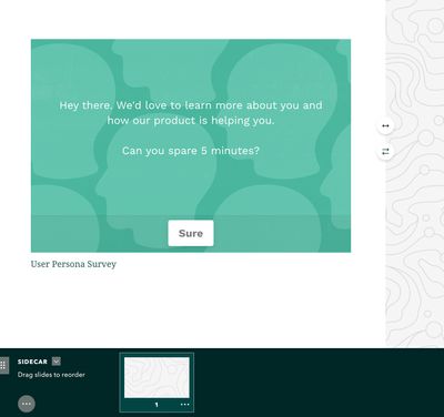

Hi @Anonymous User -- To clarify the terminology... A live embed is an embed that loads within the story. A card is essentially a nice-looking link that displays a title, description, and thumbnail that can be clicked to open the content in a new browser tab.
To answer your question...what you are looking for is something in the rich embed category because you want it to display live in the narrative panel of a sidecar.
You can browse or search the full list of rich embed sites here. It looks like TypeForm is a survey provider that is supported as a rich/live embed. Below is an example of a TypeForm survey embedded in a sidecar narrative panel.
I hope this helps!
