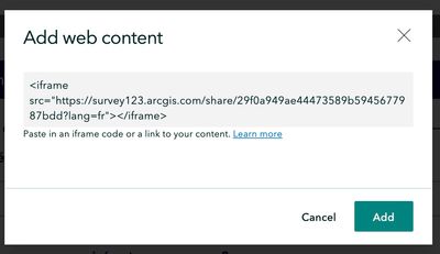

@Anneka_France -- The builder modifies the URL to try to optimize the appearance of the survey in a story, but sometimes you may want to do something different.
If you use <iframe> code for your embed you'll have more control over the URL params. So instead of pasting in the URL to the Add web content box, use iframe code, like this:
<iframe src="https://survey123.arcgis.com/share/29f0a949ae44473589b5945677987bdd?lang=fr"></iframe>

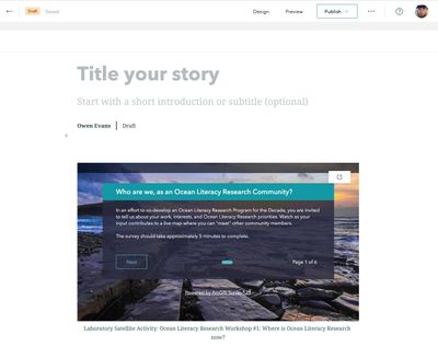

@JenMcRuer -- Looks like you need to use the full survey123.arcgis.com URL rather than the short URL. I was able to get things to work as you are expecting using the code below.
<iframe src="https://survey123.arcgis.com/share/7e0e7a6635bd4d52b43dfee7f6b60a0d?hide&embed"></iframe>
