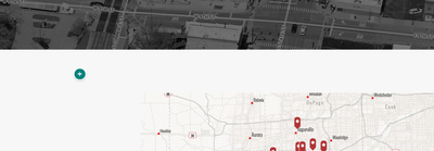

I can't find a way to remove the extra space here. You can see there are two Add content block prompts.

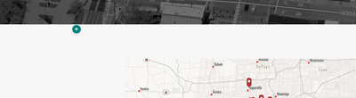

@JaredPilbeam2 -- There isn't a way to remove an empty block at the very beginning of the story, but if you type a few characters in there so the block is not empty you should be able to drag your map block above the text block and that will get rid of the additional space.
