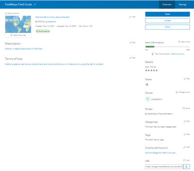

If you click on the item in your content, scroll to the bottom of the overview page, copy the link under share and use that. We've been using this method for about a year now with no complaints.

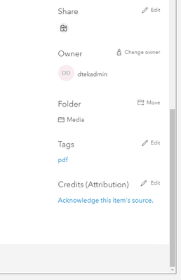

Content page does not have URL parameter on the overview page.. Last parameter is "Credits (Attribution)"

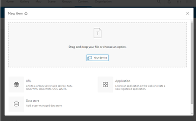

I loaded pdf file like this: Content - New Item - Choose file
