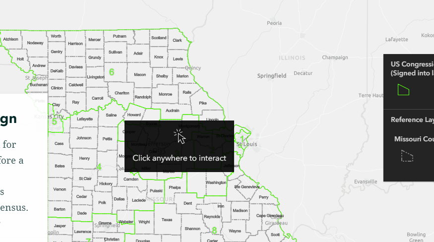

I have been choosing the option </>Embed under media, and plugging in the URL of the other site.  This works, but in use, it's adding a block instructing "Click anywhere to interact" which isn't appearing on any of the applications I've referenced local to my org.  I'd prefer to have consistent prompts and behaviors for all the maps I have embedded in my story map.    What am I missing?

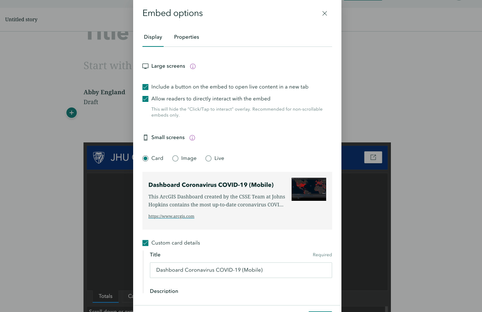

Hi @TracySchloss ,
To remove that Click anywhere to interact messaging, head into the settings on the Embed and check the "Allow readers to directly interact with the embed" box. This will turn off that "Click anywhere to interact" message.
If you do not see this checkbox, your Portal for ArcGIS organization may be at an older version of ArcGIS Enterprise, that does not have this setting.
