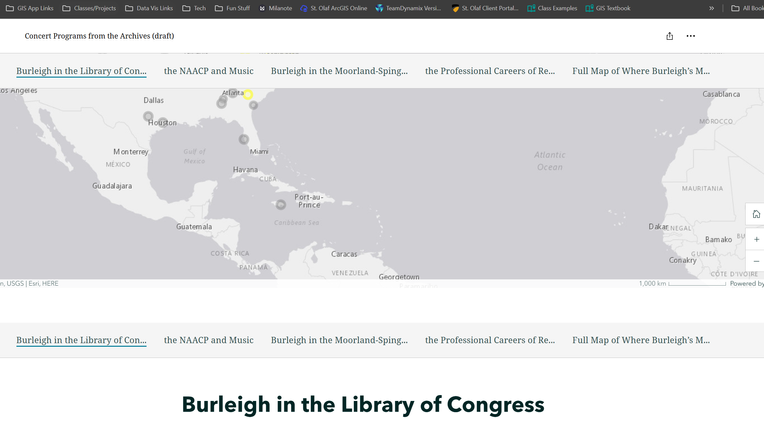

Hello everyone!
I have no idea how this happened - but somehow I ended up with duplicate navigation bars and I can't figure out how to get rid of the extra one. I've tried clearing the cache, multiple browsers, opening it in an incognito window....everything I could think of.
Here is the link to the StoryMap

Hey @SaraJL , after looking into the story, there is another navigation in the story structure (which should not happen). I also noticed the story was edited with python. Was this story created with a specific python script?
SaraJL
@ThePreatorian I created this one with the StoryMap converter tool! This is actually one I was trying to convert from the Cascade legacy template.
I converted it first - but for some reason, the tool only pulled over the top section of the StoryMap, so I had to manually recreate the rest of it. I turned on the Navigation at the very end, and that's when the duplicate bar showed up. It didn't do that with the others I was working on, so I couldn't figure out what the cause might be.
Here is the original version - when I initially converted it, it only pulled the first section. But nothing beyond the "Differences in Physcial and Digital Archive Work".
I'm hoping there is some way to salvage it. It took me at least 4 hours to recreate this one from mostly scratch.....
Any advice is welcome!
