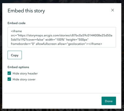

@MackenzieHickie -- Are you embedding your story in another website? If so, when you generate the embed code you can check on the option to hide the cover. Does this work for you?

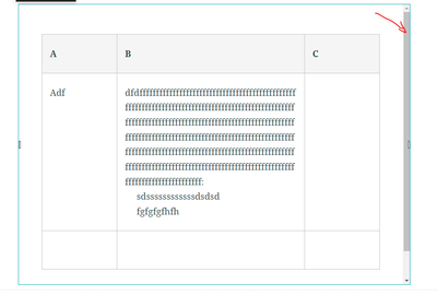

I used the same steps as you mentioned above but I got this scrolling on the right, how can I disable this or deal with it?
Thanks

@AliAwadBUK -- I'm sorry, I'm not quite sure how to help. This question appears to be more about your web page than it is about the story you are embedding in it. I'm not sure what your page looks like or what code you're using for the page you're embedding the story in.
If you can share more information here someone may be able to help, or you may get better results by posting your question on another site like Stack Overflow where you can ask a question about how to adjust the code of your web page to get the result you are looking for.

To go to that screen I showed above, view any story and go to the ... menu in the header and click Embed this story.
If you are linking to your story, you can just add "?cover=false" to the end of your story link and that will hide the cover (or "?cover=false&header=false" to hide both the header and cover). For example: https://storymaps.arcgis.com/stories/c87bc0a59c0144008e25d50a5dd1b192?cover=false&header=false
