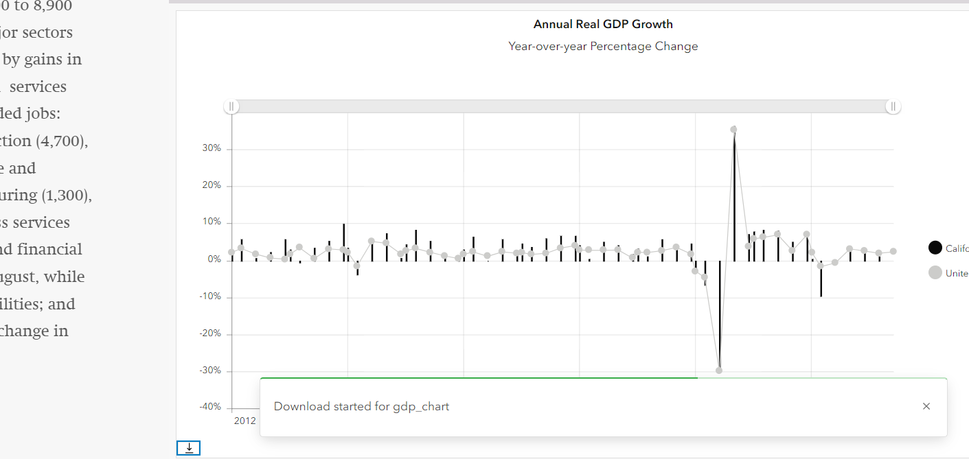

In response to feedback, we want to add the functionality to download summarized .csv data from the dashboards within the story map. I've enabled summarized data download in the dashboard. When I click the download button in the story map, there's a message that the download has started with a progress bar (see screen grab below.)
But I can't find a downloaded .csv file anywhere at the end.

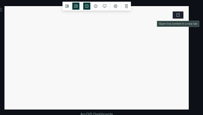

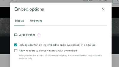

Unfortunately, this is still the case that downloading data from within embedded content is not possible due to the reason Owen had mentioned in that prior post. One way you may be able to encourage people to download the data outside of the application would be to add a button to open the app in a new tab, like this:
You could then add a note at the top of the embedded content to encourage readers to use that button to open the application in a new tab before downloading the content.
We understand this is a little frustrating as it breaks up the reader's interaction with the content, but it's our best solution at the moment to allow as much interaction with embedded content without compromising security concerns.
