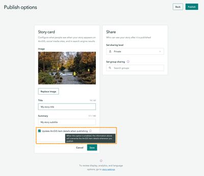

@sva2 - This is expected as the story information is automatically written to the item each time the story is published. If you have a need to have the item details differ from the story details the item details will need to be manually updated after publishing an update to the story.
In the ArcGIS Online version of ArcGIS StoryMaps, there is a checkbox in the Publish options that lets you unhook this connection to the item details. This feature will be available in Enterprise 11.1.
