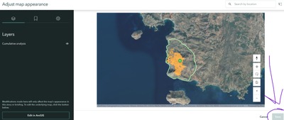

  1. When trying to add one of our web scenes to a sidecar, the "Save" button is greyed out. Up to last February, they used to contain only feature layers. Due to new specifications and complex symbology, we have switched to map tiles instead. Both asset types trigger the same issue, even when fully loaded in the viewer and waiting for up to an hour for good measure.

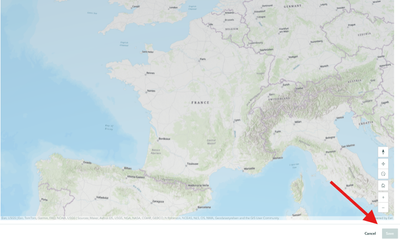

  7. There is no issue whatsoever with web maps (2D), where the "Save" button is not greyed out and the legend systematically appears.

Greyed out save button for scene in sidecarGreyed out save button for scene in sidecar
Same issue with a scene containing only a basemapSame issue with a scene containing only a basemap
Web map teasing us by working perfectly in the sidecarWeb map teasing us by working perfectly in the sidecar

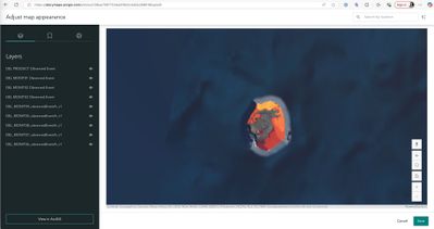

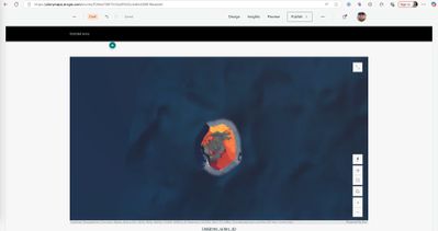

@qpoterek - I'm sorry you are having issue adding web scenes. We tested the scenes you provided and cannot reproduce the issue you described (the one with id e00803bbe5c444eeafc5e064c6c094d8 does not appear to be shared publicly, so we couldn't test that one). Below, are screenshots showing one of the scenes with an enabled Save button and the same scene placed successfully in a story. I also tested with about a dozen scenes from the Living Atlas and was unable to reproduce the issue.
I would recommend that you please contact Esri Tech Support so they can better help troubleshoot since the issue appears to be something related to your computers, network environment, or account.
