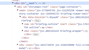

I'm a developer working with Christopher - just to add some further information to this issue, the entire header element is completely missing when we view the StoryMap via an iframe.
When the URL is viewed directly in the browser, I can see this element:
However, when I look at what is rendered within the same URL via the iframe, this header element is completely missing, and it goes straight from the storymaps-root element to the main element:
We have noticed that when the iframe is made significantly smaller (once it goes under 700px in width) the footer element does appear, and we could then use the footer navigation. However, we want the iframes to be the full width of the grid used in the website, which is more like 1200px. The header navigation element just doesn't seem to be activated at all from within the iframe.
