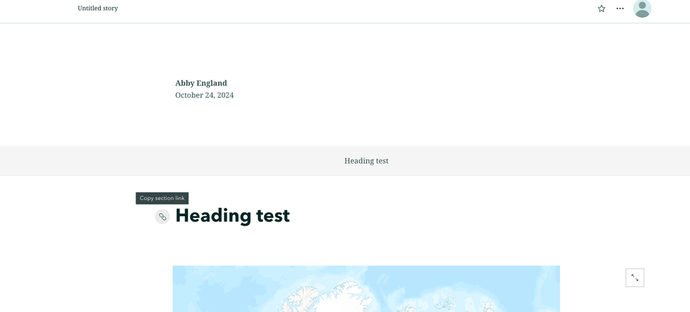

Hi @DianaLeppsoo , the only way to have those navigation links to different sections of the story is using headings, or slides if you are in a briefing. When you create a heading, it automatically creates a link that you can link when you highlight text and add a link from a heading (like in the screenshot above). That link also appears on a published story when you hover your cursor next to the heading: Screenshot 2024-10-24 at 9.43.55 AM.png
You could then use that copied section link within another story or resource, so when it's clicked, the story is opened to that specific heading/section.

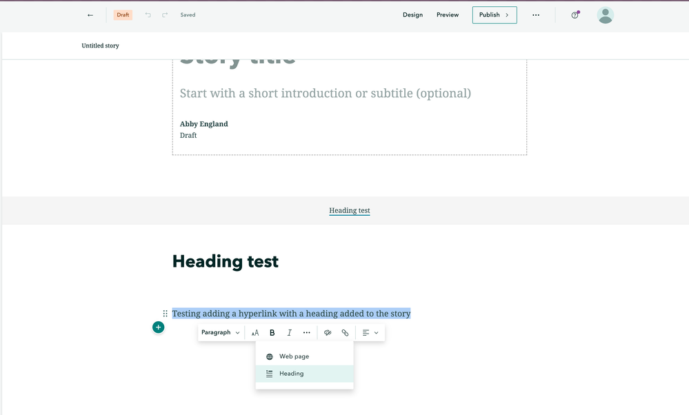

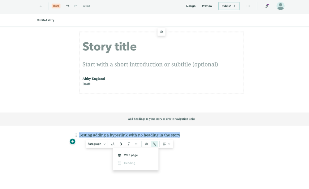

Hi @DianaLeppsoo , can you clarify what element you are adding to the story where you're looking to add a bookmark? Are you referring to bookmarks coming from a map or web app that is within a story? Or is this question more in reference to a hyperlink added to a story that when clicked, jumps to another part of the story? If it is the second case, I would note that hyperlinks to headings are only available once headings have been added. Then, that Heading option will become enabled: Screenshot 2024-10-14 at 3.10.11 PM.pngScreenshot 2024-10-14 at 3.10.55 PM.png
Let me know if this helps answer your question!

DianaLeppsoo
Supper! Exactly what I needed. Searched this function everywhere except there.
Thanks a lot!
