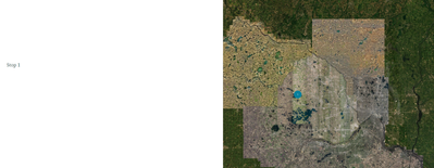

9. Publish story > view story> all Express maps are zoomed completely out:
Feel free to let me know if you have any questions.
