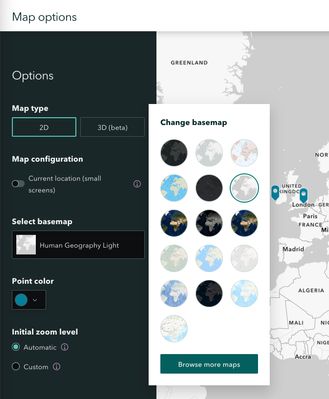

I created a web map (sharing level: owner) w/ just two layers, one with points, the other polygons. Is my thinking incorrect that this web map should be accessible in my storymap? I'm wanting to add a map tour and utilize the web map but can't seem to figure out how to bring it in. I thought the 'start w/ feature service' would allow me access to it but my web map doesn't appear via that route. Where am I going astray? Thanks....

To bring in your own layers to a map tour you do that by going to the map tour's Map options, then click the basemap button, then click Browse more maps, and pick your web map. That will bring in the basemap and its layers into your map tour.

Thanks again, Owen. I was able to pull in the needed info. 👍
