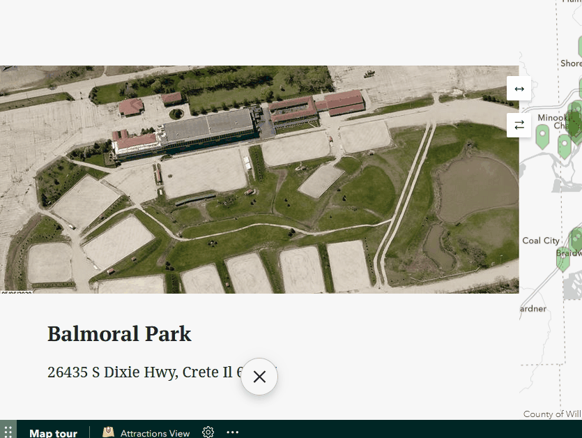

Our ArcGIS Story Map includes a Map Tour (Explorer, Grid layout).
Attributes from the underlying Feature Layer populate the Place Title and Place Description for each location shown on the map. I’m trying to use some basic HTML in the Description but not having much luck. For example, <strong> works but not <br> nor <p> - which are what I've been trying in order to display with a blank line between sections of the Description. .
I’ve seen this https://doc.arcgis.com/en/arcgis-online/reference/supported-html.htm but that list doesn’t seem to apply to a Map Tour.
Welcome any insight.

I have a lot of points and the Map Tour seems the most feasible for this. So, I support this idea as I'd like a way for the end-user to get more info on the points.
JaredPilbeam2
Since you cannot have pop-ups in the map I'd like to have a multi-line description in the side bar.
For example, right now I can show the title and address. But, it would be great to be able to show the address as well as the website (as a link).
