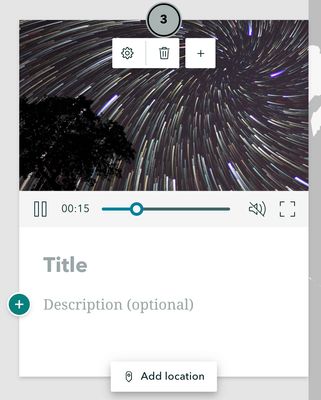

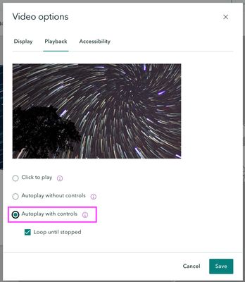

@HeatherRoy -- In March 2025, ArcGIS StoryMaps received an upgraded video player that makes it possible to go full screen with map tour videos.
You'll just need to update the Playback option to Autoplay with controls (or click to play), which will show video controls that contain a full-screen button that works as you expect. Clicking on the video itself still toggles play/pause for accessibility reasons.
