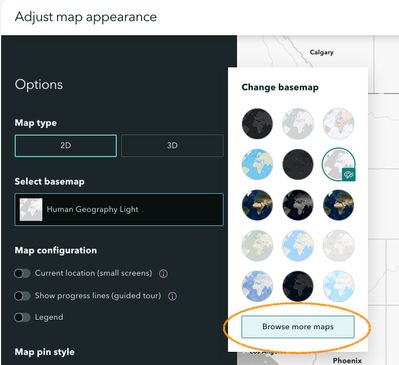

@SteveCole - You can do this today by 1) creating a web map that has scale dependent basemap layers and then 2) configuring that web map as the map tour basemap (using the "Browse more maps" button, see screenshot below).
For the web map:
  1. Select the basemap you want to appear at small scales from the basemap picker (topo, for example)
  2. Manually add the layer(s) for the basemap you want to use at large scales (imagery, for example)
  3. Set the visible range on the basemap layers as needed to show them at whichever large scales you want
You could even get tricky and configure multiple basemap layers with different visible ranges and combine that with different custom extents for individual places if you had more than one additional basemap you wanted to use.

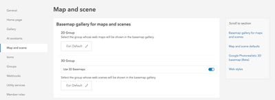

Regarding the different basemap versions...it sounds like your organization may have set its own group of basemaps for the map viewer that does not include the standard vector tile ones. If an organization uses the Esri Default basemap group, those basemaps will be the same vector tile basemaps included in the map tour basemap picker.
Here's some more info you can share with your administrator.
Configure map and scene—ArcGIS Online Help | Documentation
