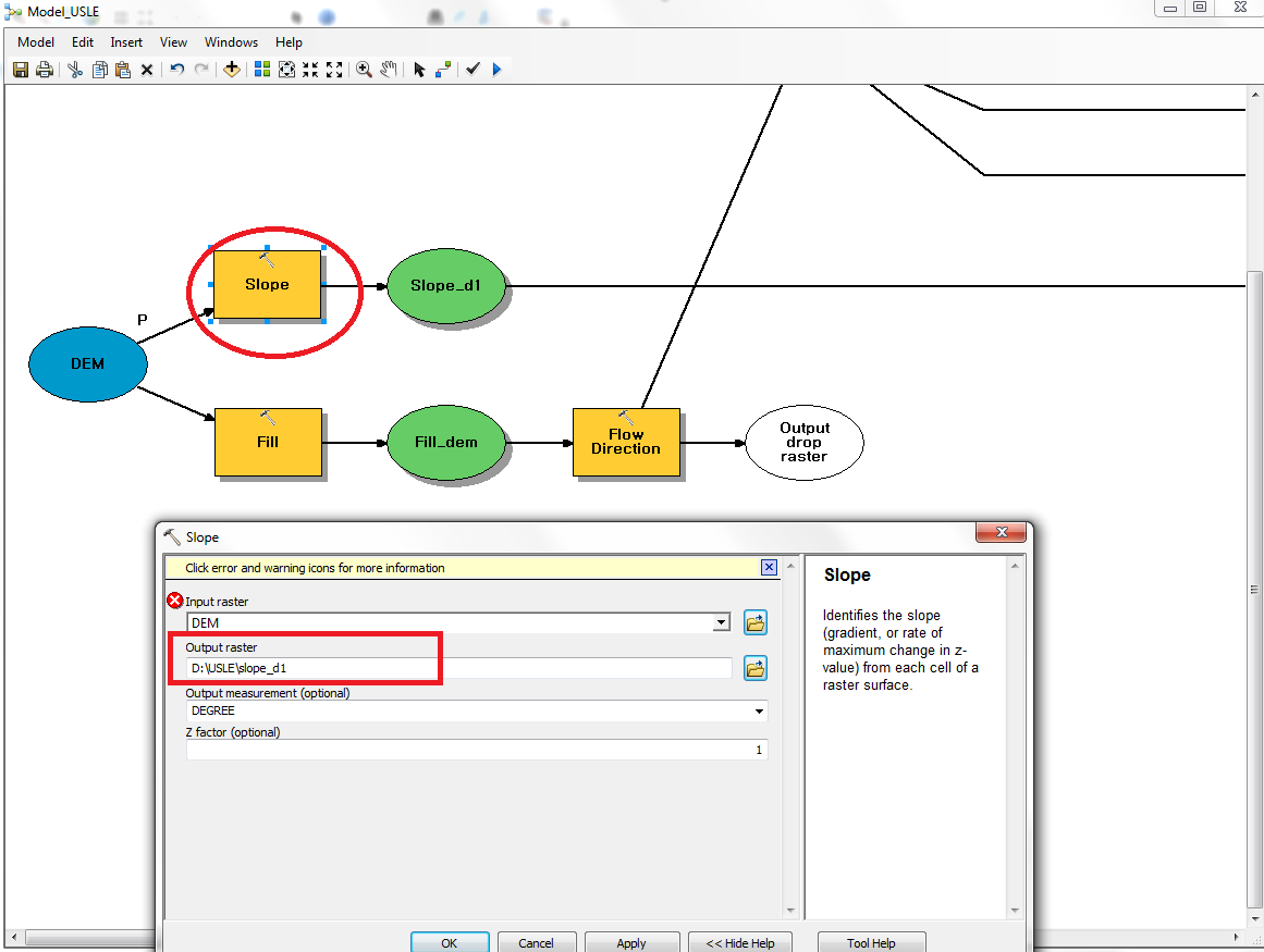

SIR D drive is not available, what to do in the edit option?can tel the steps to be done?
JayantaPoddar
MVP Alum
Hi Deepa,
The issue is that the output location in the tools refer to D-drive, which is eventually not there in your system, thus the error popping up.
Go to ArcCatalog > (Locate the path of the model) > Right-click the model > Edit
In the model-builder window, double-click the tools (in orange) and define valid output file path. The default model had D-drive in path. Verify for all the tools. Also make sure you replace the DEM with the DEM file available with you. Also verify K_factor, C_factor, P_factor, and R_factor.
Let me know if the issue persists.
