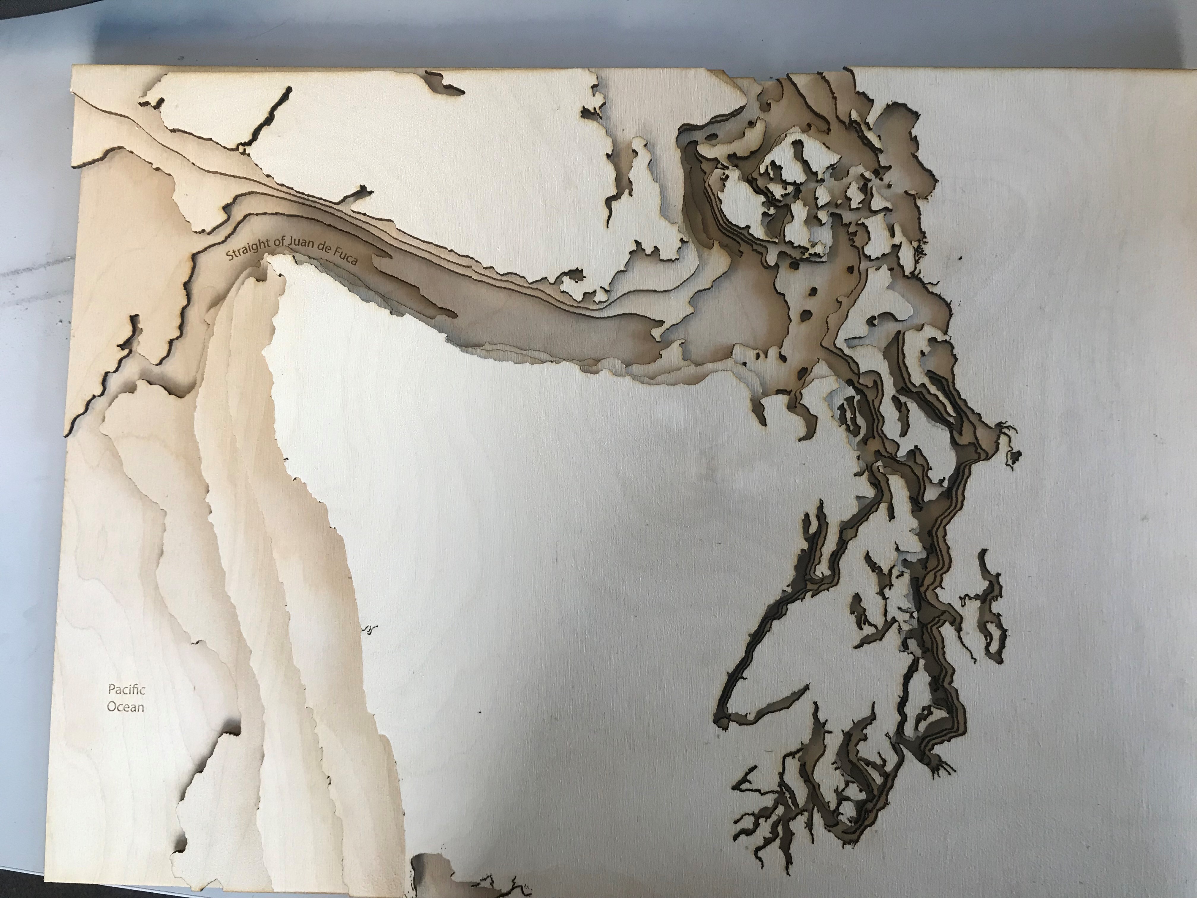

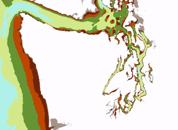

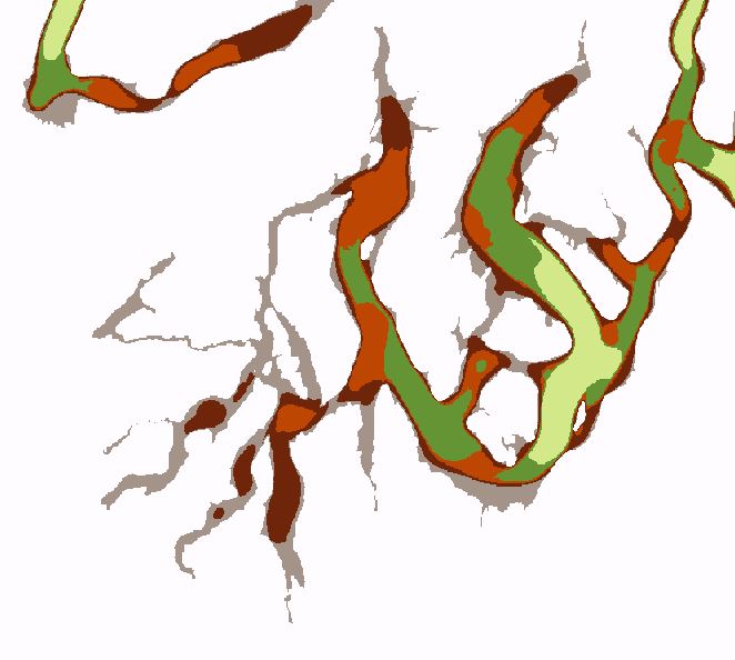

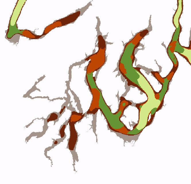

ANY help on how to get these kids going again would be appreciated.  I think if I can get smooth contour lines, I will be OK with the rest.  The below pictures are:
1. Wide view of the bathymetric contours
2. close-up (not smooth)
3. Same view after changing the neighborhood from 3 to 10...pixels gone...but not smoothed?
4. The project so far
