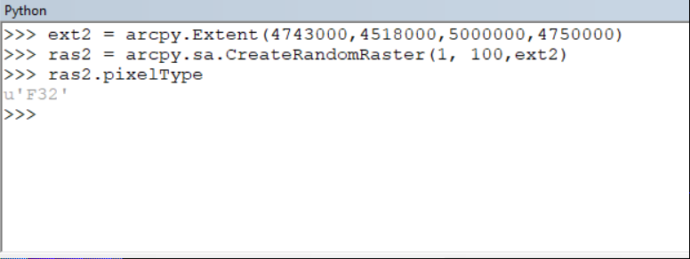

AlbertoAloe
but....if I make it a bit smaller...(maxx= 5000000, maxy=4750000)
it works !!
Alberto
DanPatterson_Retired
MVP Emeritus
Then you lack memory to complete the task
