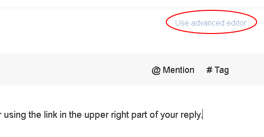

When you reply to this thread you can use the advanced  editor using the link in the upper right part of your reply:

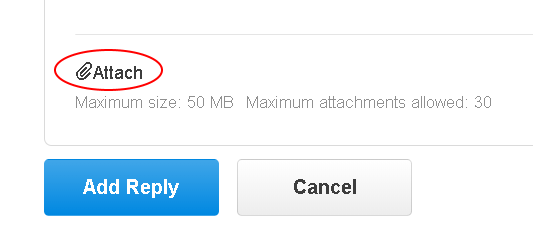

In the advanced editor you will find in the lower left corner a link that enables you to attach your data (if it is smaller than 50MB):
https://community.esri.com/servlet/JiveServlet/downloadImage/2-787828-415222/300-156/pastedImage_1.png
https://community.esri.com/servlet/JiveServlet/downloadImage/2-787828-415259/360-154/pastedImage_1.png
