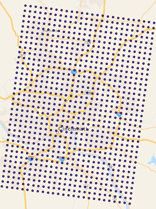

The point feature layer that I have looks like this.

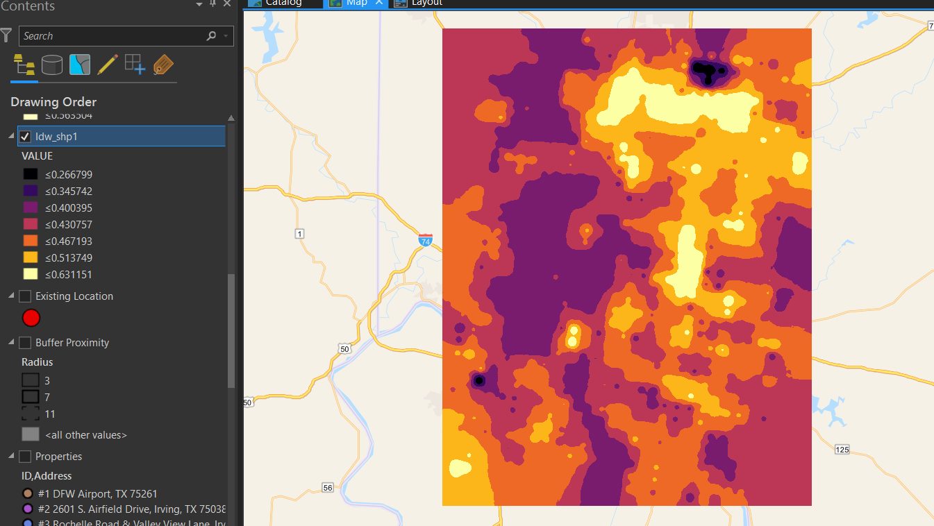

This feature layer has a field named "Total Score" based on which I perform IDW interpolation and generate a raster heat layer which looks like this. The resampling technique that I used here to display raster is Bilinear Interpolation.

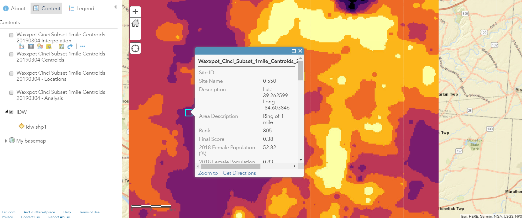

Now I can see that the popups only for some raster pixels where the earlier points were located like this
But if I click anywhere in between the grid points (marked in black above), no attributes show up since it isn't configured as popups. It simply shows "No Information Available"

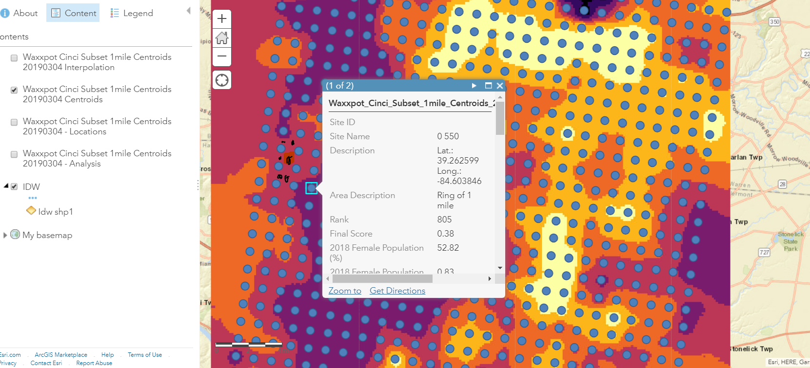

I have also tried to generate a Fishnet in ArcGIS Pro along with the point layer which are centroids of that fishnet
Now I have used a spatial join so as to bring the attributes of each point to its corresponding cell/square.
Now when I publish this resultant fishnet into AGOL and assign their attributes to raster, it worked and showed up.
