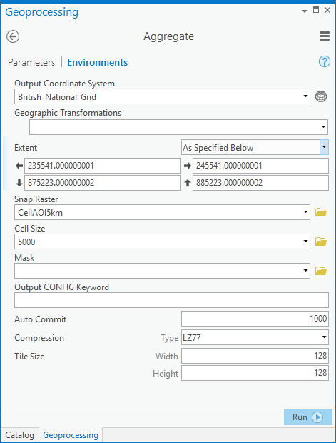

I populate the Aggregate (Spatial Analyst) as follows:

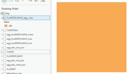

The output is a single 5*5 cell with the value 496?
I get the same output when I try and calculate other statistics?
Am I doing something wrong?
JuanLaguna
Hi David.
It looks like you set the Cell Factor to 1 and the Environment Cell Size to 5000 (m).
I think if you try setting the Cell Factor to 5, and leaving the Environment Cell Size to the default (or 1000m), you should get the results you're expecting.
The intention of the tool is to produce a coarser (reduced resolution) version of the input raster, with the multiplier specified by the Cell Factor.  In the scenario described above, the input is essentially being resampled to the 5000 m resolution first, before any statistical option is applied.
