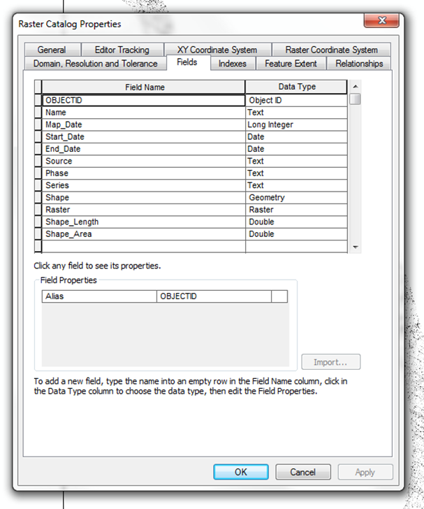

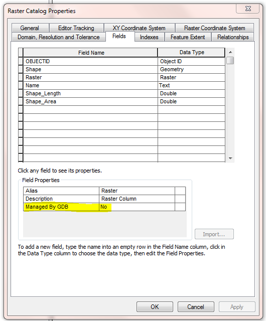

Is the Raster Catalog managed or unmanaged?  If you right-click on the raster catalog in the Catalog window > Properties > Fields tab > select the Raster field.  It will then state whether it's managed (YES) or unmanaged (NO).  Ex:
JodieParkes1
HI Jake,
There's actually no mention of if the raster catalog is managed (see below). Is this the issue?
JakeSkinner
Esri Esteemed Contributor
You will need to click on the Raster field (3rd from the bottom) within this window.
JodieParkes1
Got it - yes it is managed by GDB...

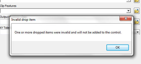

I'm not sure how to move forward on this one. I have now found the source of the images that make up the raster catalog and when I have added them in (TIFF format) I cannot merge and clip them either! This box comes up each time...
