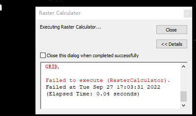

Raster Calculator Flow Accumulation Failed to execute,GRID.
2303
09-27-2022 02:10 AM
HuaxinWang
I use a raster calculator to get Flow Accumulation above 3000 or 5000.
But it could not execute.
I have done this calculator with other rasters many times and they all worked out very well.
I don't know why this time is not ok.
I googled it but could not find a solution.
Please help me out of this.
Thank you very much.

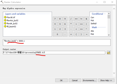

what was the raster calculator expression?  you have scrolled to the bottom of the error and not shown the full error message.
Doe it just fail for esri grid output? or did you try saving to a *.tif in a folder?
... sort of retired...
HuaxinWang
Thank you, Sir. It is very helpful.
I did not save it as a .tif.
It worked out when saved as .tif.
I will find out why.

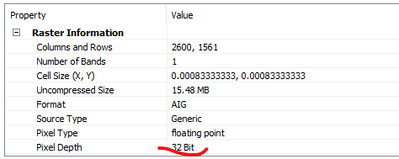

DanPatterson
MVP Esteemed Contributor
If memory serves esri grids aren't 32 bit, whereas tif can be
HuaxinWang
Woo.
Thank you very much for your explanation.
It would take me a while to find out that.
I will study it.
