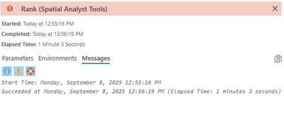

I am trying to use the Rank tool, in the spatial analyst toolbox, and it fails without providing an error message. The message says it succeeded - but the tool failed and there is no output:

your comparison 'raster' is a constant. but you didn't indicate what you set for the environments
See the first parameter
A number can be used as an input; however, the cell size and extent must first be set in the environment.
So are the cell sizes and extents the same for the inputs? and was it specified for your constant value (first input)?

Thank you for sharing this. I am Nishani Moragoda from Esri. We tried to reproduce this issue with your data, but the Rank tool worked as expected for your test case in ArcGIS Pro 3.5, and we could not reproduce this error.
Could you please provide any additional details that might be relevant to this, such as any environments specified, how the input data were created, available storage on the C drive, or any other information that might help us reproduce this issue.
