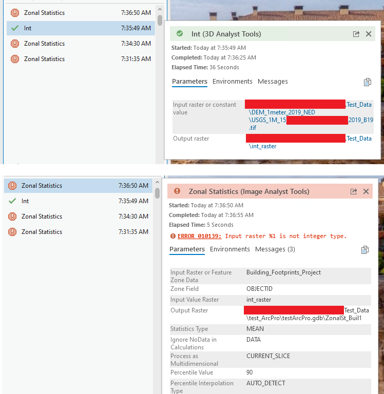

We are having trouble with the Zonal Statistics tool in ArcGIS Pro, while trying to improve our surfaces, planimetry, and potentially implement 3d Buildings...  part of that workflow involves 'flattening' Building Footprints in a Digital Terrain Model: we have the Building Footprints as a polygon feature class and a DTM derived from a LAS dataset, and nestled within the script-tools is a call to ArcPy Zonal Statistics, where we caught our error:
"Error 010139: Input raster %1 is not integer type".
Simple enough!  So, we started working with the Zonal Statistics tool on its own and easily reproduced the same error, given the Polygon FC and Floating Point DTM raster.  According to the contemporary documentation (Zonal Statistics (Spatial Analyst)—ArcGIS Pro | Documentation), ZonalStatistics should accept Float for Mean (the config we were using).
We've tried:
1. running Int(raster) first, and received the same error.
2. replacing our derived-DTM with a USGS NED DEM and received the same error.
3. switching between a dev workstation (ArcPro 3.5.1) and a 'clean machine' (ArcPro 3.3.0).
We're curious:
A. Why is the Tool erroring on 'Int' when it should accept Float?
B. Why is the error seem to suggest the name of the input Value Raster is "%1"?

I am Nishani Moragoda from Esri. The error you have encountered is potentially due to the use of an unsupported zone field from the input zone feature class. The Zonal Statistics tool currently does not support fields with the data type ‘Big Integer’ as the Zone Field. Please check if the OBJECTID field in the Building Footprint zone dataset is ‘Big Integer’, and please consider using a different field as your zone field.
We will work on providing a better error message to indicate this. Additionally, we will plan to support big integer fields for Zonal Statistics in the future.

Good ideas David!  We had tried using plain old .tif too, with the same error.  We learned the error was a result of the input feature class.  We had some success with the long-way round: 1) convert polygon to raster, 2) run Zonal Statistics.
Unfortunately, that leaves us to try and bodge this workaround into a prepackaged Toolbox, where ZonalStatistics is one of about 15 steps!  Maybe we'll start by trying to remake the 'zonal polygons' Feature Class today and see what we can find...
