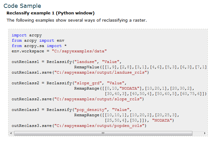

I was thinking about his idea of doing it all at once, after building the remap table
eg.
remap = RemapRange([[1000, 2000, 1], [2000, 3000, 2],  [3000, 4000, 3]]
out_reclass = Reclassify(raster, "Value", remap, "NODATA")

That is helpful, but still not fixing things.  But now I'm starting to think is is how I am building the reclassArg value.  if I set a new value to the value of reclassArg and follow hints in the other thread, it clearly shows that my variable is not seeing it as a list.  Looks like I need to work on the formatting, then test again
>>>reclassArg
'[[327.850126532, 1000.0, 1000], [1000.0,  2000.0,  2000], [ 2000.0,  3000.0,  3000], [ 3000.0, 6500.0, 6500]]'
>>> zzz = '[[327.850126532, 1000.0, 1000], [1000.0,  2000.0,  2000], [ 2000.0,  3000.0,  3000], [ 3000.0, 6500.0, 6500]]'
>>> remap = RemapRange(zzz)
>>> remap
RemapRange([['['], ['['], ['3'], ['2'], ['7'], ['.'], ['8'], ['5'], ['0'], ['1'], ['2'], ['6'], ['5'], ['3'], ['2'], [','], [' '], ['1'], ['0'], ['0'], ['0'], ['.'], ['0'], [','], [' '], ['1'], ['0'], ['0'], ['0'], [']'], [','], [' '], ['['], ['1'], ['0'], ['0'], ['0'], ['.'], ['0'], [','], [' '], [' '], ['2'], ['0'], ['0'], ['0'], ['.'], ['0'], [','], [' '], [' '], ['2'], ['0'], ['0'], ['0'], [']'], [','], [' '], ['['], [' '], ['2'], ['0'], ['0'], ['0'], ['.'], ['0'], [','], [' '], [' '], ['3'], ['0'], ['0'], ['0'], ['.'], ['0'], [','], [' '], [' '], ['3'], ['0'], ['0'], ['0'], [']'], [','], [' '], ['['], [' '], ['3'], ['0'], ['0'], ['0'], ['.'], ['0'], [','], [' '], ['6'], ['5'], ['0'], ['0'], ['.'], ['0'], [','], [' '], ['6'], ['5'], ['0'], ['0'], [']'], [']']])
So, at least that helps...maybe.
DanPatterson_Retired
MVP Emeritus
check my format string which doesn't cast the variable as a string which yours does, it casts it as a tuple. If you build the table as in curtis's example then you should have the format you need  Curtis should be online soon
