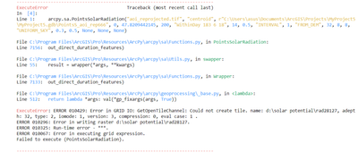

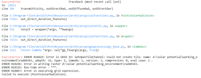

The error message I get is
What might have gone wrong? For your information, I am running this inside ArcGIS Pro
nibar
Update: When I run the core Point Solar Radiation tool with the same data, I get some results without any error. But when I copy the Python code for the same tool and run it, I get the same error as above.
