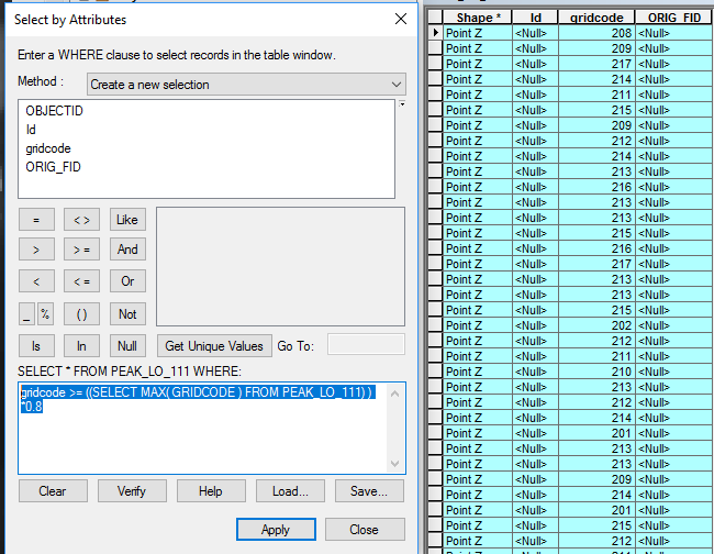

JohnnyJohansson
Thats works fine if I have exported the shapefile to a database, but if I have a created feture class indide a database the same querry selects everything, What I'm I doing wrong here?
JohnnyJohansson
Well.... I dont see what I'm doing wrong here.... with this code I just selects everything...
gridcode >= ((SELECT MAX( GRIDCODE ) FROM PEAK_LO_111) ) *0.8
FC_Basson
MVP Alum
The caps of the field name in the statement needs to be consistent eg SELECT MAX(gridcode)
