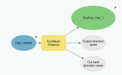

Hi, is there any way to hide the "output direction raster" in the model builder after you´ve done the euclidian distance? Just asking out of esthetic reason due to the presentation of the model.

I couldn't get rid of the "Output Direction Raster" and "Out Back Direction Raster" in the Model Builder, even though they are optional parameters. At least, not directly.
What I could do, is using a model (submodel) within another model.
My first model (submodel) would look like the normal one. I am defining the Input Feature and Distance Raster as Parameter. I saved this model.
Then, I added the above model into another model. He is how it looks.
You can present the second model for aesthetic purpose.
