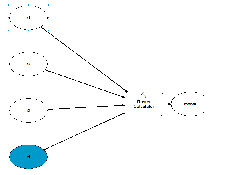

Current Attempts
I have built a model, however this only runs on the rasters I provide it, requiring me to write a new expression each time. In other words it's the same as manually running raster calculator and writing a new expression for each month, I wish to automate this via modelbuilder.

TomHawkins
Deactivated User
Hi Dan, I've been reading up on iterators and trying to wrap my head around them.
In the examples I have seen it seems it will cause the raster Calc to run on EACH of the rasters. Whereas I only want it to run on GROUPS of the raster, which are grouped by month.
i.e. I want the following...
(janweek1+janweek2+janweek3+janweek4) /((janweek1+janweek2+janweek3+janweek4))= jan.png
(febweek1+febweek2+febweek3+febweek4)/(janweek1+janweek2+janweek3+janweek4) = feb.png
yet from my understanding the iterator will produce something akin to
janweek1+janweek2+janweek3+janweek4 + febweek1+febweek2+febweek3+febweek4....=month.png
