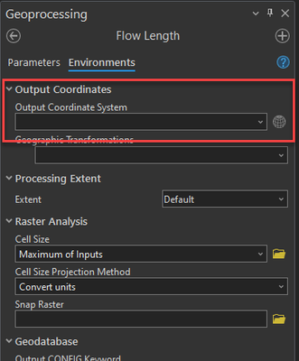

Try setting the Output Coordinate System to the PCS in the Environments of the tool:
JoshDawe
Hello @JakeSkinner thank you for the suggestion. It worked and I was getting meters.

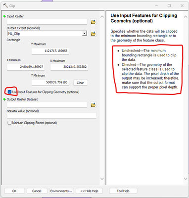

In case anyone else comes across this post there was another issue.
When I used Clip (which is under Data Management tools>Raster>Raster Processing) I didn't have the "Use input features for clipping geometry" checked. I needed to check this in order to clip my data to just my water shed. When it was left unchecked my data clipped to a simple rectangle around my water shed which was giving me a longer length on my main channel.
