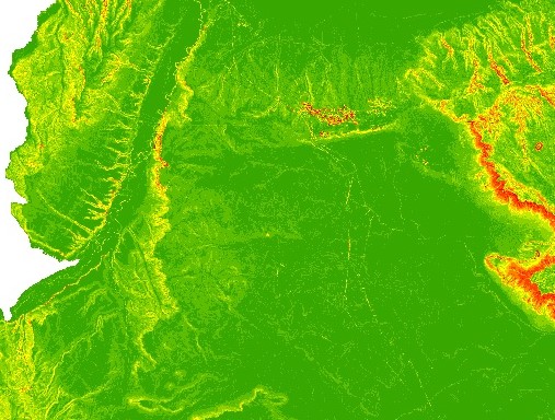

well, I tried in this way: I extracted by mask the river raster, reclassified it with a value of 0; then I reclassified the slope raster (the main one, I mean) with values starting from 2 up to 10 and merged both into a new raster. Afterwards, I used the path distance tool (in order to obtain the cost surface, the back link raster and using also the tobler's function). In the end I applied the cost path tool. I worked, the river is used as main path to reach the other points.
But I have two questions: could it be considered correct this method? Since I gave an higher value to the main slope (i.e. reclassifying it), could the result be wrong (see pic1 not reclassified, pic2 reclassified)?
RobertoFilloramo
not reclas
Pic1_not recls
reclas
Pic2_reclas
