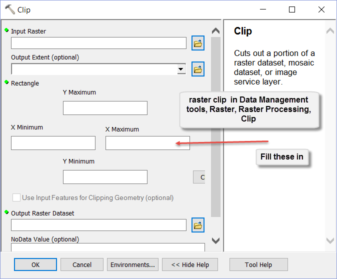

so you  want to split it into 4... we will use the clip tool, I am assuming you mixed up East and west
              5,020,000
500,000                   532,100 =>   difference = 32,100  / 2 = 16,050
             4,960,000
N-S difference = 60,000 / 2 = 30,000
bottom left extent
              4,990,100  to give the upper 100 overlap
500,000                  516,150   to give the 100 m overlap
              4, 960,000
repeat for the other 4 quadrants

Clip—Help | ArcGIS for Desktop you just have to do the math by setting the correct extent each time, you can control your bounds.  There are probably fancier ways but this will be the fastest

Im not sure what you mean by control your bounds?? Im new to ESRI my bounds are North 5020,000, South 4960,000, East 500,000, West 532,100. How is this done by setting the extent?

Thank you so much Dan for your help on this, i tried both methods and i liked the clip raster function better. I appreciate your help thanks again

or SplitRaster
