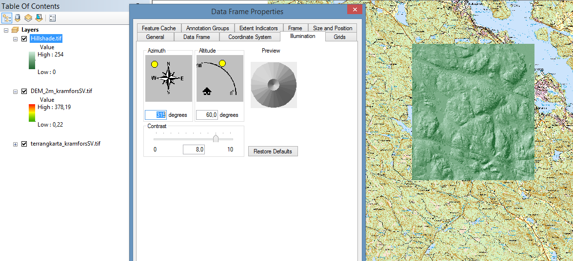

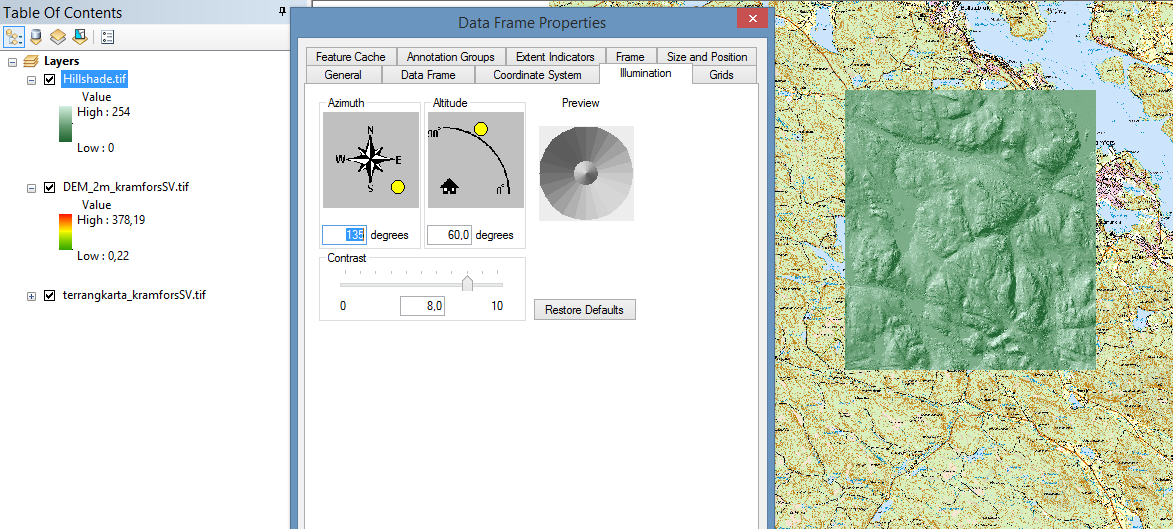

Hi, I'm working on a hillshade layer of a DEM and want to change the illumination. I opened the Data Frame Properties and the Illumination tab. Here I changed the azimuth, altitude and contrast several times in order to see a change in the Hillshade layer, but no matter the degree, altitude or contrast the picture looks the same. Why is nothing happening?
Many thanks,
Linn
 This is a picture of the Hillshade at 315 degreesThis is a picture of the Hillshade at 135 degrees

recalculate the hillshade using the different values if you want to see a difference in the hillshades

Thanks!!
