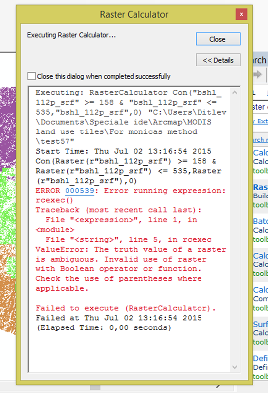

I typed in raster calculator with those variable and expressions:
Con("bshl_112p_srf" >= 158,0000001 & "bshl_112p_srf" <= 535,"bshl_112p_srf")
It works now, but the output raster is first of all still covering the whole input original raster (not only the interval mentioned) and also the values are just termed 1. So all values have been reclassify to class 1, even though they were not inside the interval.

I still get the same error message
I type this:
Con("bshl_112p_srf" >= 158 & "bshl_112p_srf" <= 535,"bshl_112p_srf",0)
And I have changed the nodata to 0.

Everything is typed in directly in raster calculator.
I tried to move it to a shorter path and added float(),
Float(Con("bshl_112p_srf" >= 158 & "bshl_112p_srf" <= 535,"bshl_112p_srf",0))
still the same error message.
If i type for instance:
Con("bshl_112p_srf" ==510 ,"bshl_112p_srf")
then this works with no problem. So the problem should be related to the <= and >=.
