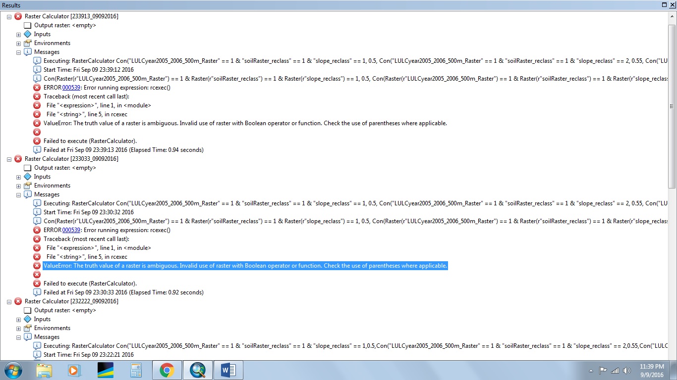

Its for preparing a map with appropriate Runoff coefficient value based on Landuse, Slope and Soil type. Unfortunately, each time I run it I come accross this error message: Screenshot of error message

At first glance, I suspect the issue is the use of parenthesis.  Just an educated guess - wouldn't there be parenthesis at the end of the parameters for each CON statement instead of a pile of them at the end?

It is to do with parentheses, but in the sense that you need them to delineate consecutive Boolean expressions. From your link:
When using multiple Boolean (~, &, ^, |) and/or Relational (<, <=, >, >=, ==, !=) operators consecutively in a single expression, parentheses should be used. For example, parentheses are required in the following expression (a>2) & (a<5).
outRas = (Raster("a") > 2 ) & ( Raster("a") < 5)
So:
Con(("LULCyear2005_2006_500m_Raster" == 1) & ("soilRaster_reclass" == 1) & ("slope_reclass" == 1), 0.5, ...

Try putting the parentheses around the statements involving "=="
Con(("LULCyear2005_2006_500m_Raster" == 1) & ("soilRaster_reclass" == 1) & ("slope_reclass" == 1), 0.5, Con(("LULCyear2005_2006_500m_Raster" == 1) & ("soilRaster_reclass" == 1) & ("slope_reclass" == 2), 0.55...
