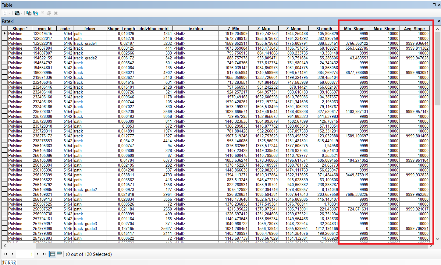

So I have mountain trails/tracks as polylines and I want to determine their difficulty/grade: easy, medium, difficult. In order to do that I have to work with slopes and elevation. I am using ASTER SRTM for that manner. I followed these instructions but the values I'm getting for the slopes are weird (see the picture).
What am I doing wrong here? Is there any other way for me to find the difficulty of the tracks?

how are you calculating slope?  And by the looks of your shape_length field, I suspect that you aren't using projected data but your coordinates are in decimal degrees and your elevations are in meters.  Project your file to a suitable projection so that all your positional values are in planar units.  Once you have fixed that, then make sure you decide whether to record slope as either a percentage or in degrees...

Thank you! You saved me
Do you think this is the proper method for determining the difficulty of the trails?

definitely one way... you could also incorporate the concept of the length of a slope as well ... it will be more difficult to follow a 10 deg slope for 1 km than one that is only 10 meters.
