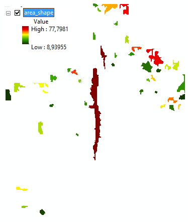

It would probably yield something like this:
Steps used:
  • Region Group -> "region_group"
  • Lookup using the field Count -> "lookup"
  • Raster Calculator: Con(Raster(r"lookup")>= 25, Raster(r"region_group")) -> "region_group_large" (to filter out the small areas)
  • Zonal Geometry, using the PERIMETER option -> "area_perimeter"
  • Zonal Geometry, using the THICKNESS option -> "area_thickness"
  • Raster Calculator: Raster(r"area_perimeter") / Raster(r"area_thickness") (the resulting raster with the relation between the perimeter and thickness)

I think you could... at least get close.
First of all you are interested in the areas of snow below the approximate snow line. These can be extracted using some raster math. The next thing would be to identify each separate connected area. This is done with the tool Region Group—Help | ArcGIS Desktop .
The next thing could be to identify some statistics for each area. You could for instance do some Zonal Statistics and determine the range of values in you DEM for each unique zone. See: Zonal Statistics as Table—Help | ArcGIS Desktop
Now when the range is large this does not necessarily mean that the zone contains avalanche debris. You could perhaps better use the Zonal Geometry tools and determine the fraction between the perimeter and the thickness of the area:
How Zonal Geometry works—Help | ArcGIS Desktop
The greater the resulting value the more probably will be that it is avalanche debris.
Steps used:
