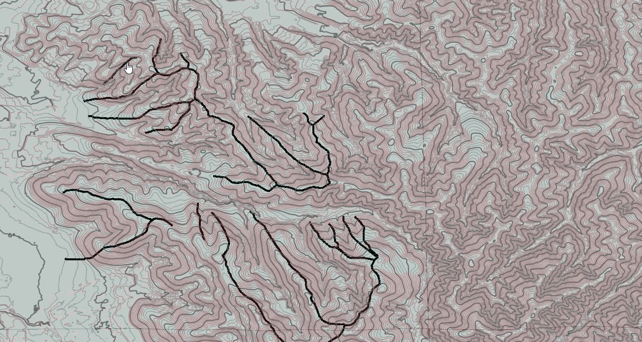

The problem - To draw polylines or polygons that represent 100ft vertical setback from the ridges (see 2nd screenshot). My study of area is approx 1500 acres. Here is a screen shot.
This is what I have done thus far after soliciting help from the 3D forum and nearby GIS expert. Thus far, all is running on ArcGIS Pro with both SA and 3D available.
Attempted Method 1:
Semi-manually created 3D ridgelines (as shown in black in the screen shot above, and this is not an issue here, let's ignore why the lines have to be manually edited). In Scene, make 2 copies of a ridgelines and duplicate them 100ft vertically down from the original location. The duplicate lines were placed on either side of the ridge while viewing in 3D. Convert the lines to 3D points (Feature Vertices to Point). Then create contour polyline from the 3D points (Add Geometry Attribute then Points to Line). Build a Terrain Dataset, and use Surface Difference tool to create a polygon. The contour polyline was set to hardline. I played with this method twice at the same location with variance in width (meaning how far apart I placed the duplicated lines) but I yield different result depending on how far of the offset lines I placed.

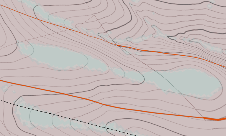

Here is snapshot what the Planners would like to see, a band that traverse along the hillside. Thank you.

Chris - Thanks for helping again. I should've posted this earlier. I follow these steps to create the ridgelines, but the outcome gets to too granular hence I have to go in and do manual editing.

Dan - I owe you a clarification. The Figure 1 below is the same area as what's shown on this post above. Figure 1 is a 2D/Ortho view. The black line (not show earlier) is the derived ridgeline. The orange lines are approximation of where the horizontal warped plane would intersect with the ridge 100ft vertically below the ridgeline. The orange line is just a representation that may be incorrect. I merely want to show what the Planners desire to see on paper. From 3D perspective, figure 2, the orange line conform to the hillside terrain. Sorry to keep on repeating, but orange line is what I need for representation but may not be correct in the figures shown below. Does that make sense?
Figure 1 2D - orthoview
Figure 2 3D
