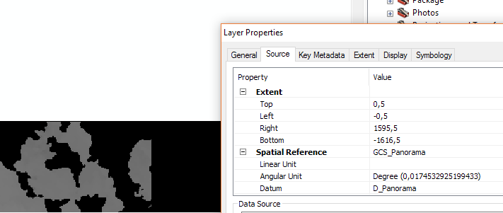

Extent of original (No spatial reference)
Extent after GCS_panorama has been applied using `define projection`. For some reason the whole image becomes skewed, or flipped, or something.
Running the mouse over the image...
bottom left corner is -186, -85 Decimal degrees
bottom right corner is 177, 86
top left corner is -179, 0 degree
top right corner is 180, 0 degree

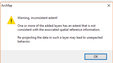

This error appears if I removed the PNG and re-add after GCS_panorama has been applied
Any thoughts?

You've got to do both--make sure the world file is applied to convert the raw pixel coordinates to latitude/longitude values and define the Panorama geographic coordinate system so that the system understands the earth model that's being used. I think once you do that, AND set a custom geographic transformation (between Panorama and WGS84, method: geocentric translation, parameters: zeroes), it will line up.
Defining Panorama without using the world file means that the raster's extent values wrap around the entire world (they're greater than 360 degrees) thus the weird display.
See this topic about world files for more information.
