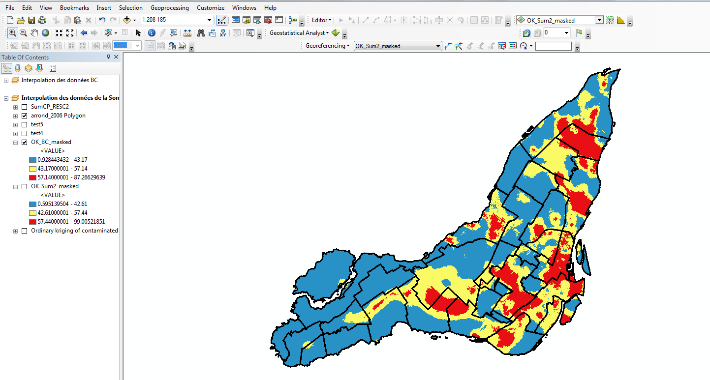

To be more explicit, we generated two interpolation grids using the kriging method for contaminated soils from two groups among ala contaminated soil classification scheme adopted by the Ministry of Environment of Quebec. The soils of the BC class (contaminated) represents the interpolated surface grid for this class. The second class represents C + and C + RESC soil very contaminated.
After interpolation of the two categories that represent the same sampling point, we wanted to overlay the two grids to get a final grid that gives us an overall picture of the contamination.
For this, we performed a classification of pixel values, according to three classes, based on the class limits determined by the statistics obtained for the soils of the BC class and C + and C + RESC. By performing the overlaid of two raster layers, we would like to have the pixel values ​​of the BC layers and C + and C + RESC that fulfill the criteria we determined. The result of the Con is depected by the last image.
See attachment  below.
Regards
Grid_BC.pngGrid_C+C+RESC.pngOverlaid BC and C+RESC.pngon

Thank for your answer. I've tried the Con argument you pointed me out based on the criterion we determined to overlay the two raster grid we generaeted. Curiously, I get the same result as a simple addition operation between the two layers. View the files attached to the answer of Darren post.
I'm wondering if our reasoning does make sense?

Hi, if I understand well, you are trying to adjust the superposition raster pixel values in order to show up the contamination for the cases you have contamination in one of two grids but when you do the sum of their contamination limit intervals values, it disappears. I guess, if you fix 85 (42+43) as a limit for a contamination class of the superposition grid, and you have values greater than 42 (image 2) and less than 43 (image 1), your superposition grid (image 3) will not show the contamination represented by the values greater than 42 of image 2 and the values less than 43 of image 1 because their sum is less than 85 (for example 45+30=75). I think your conditions are good, I don’t know why it doesn’t work.
