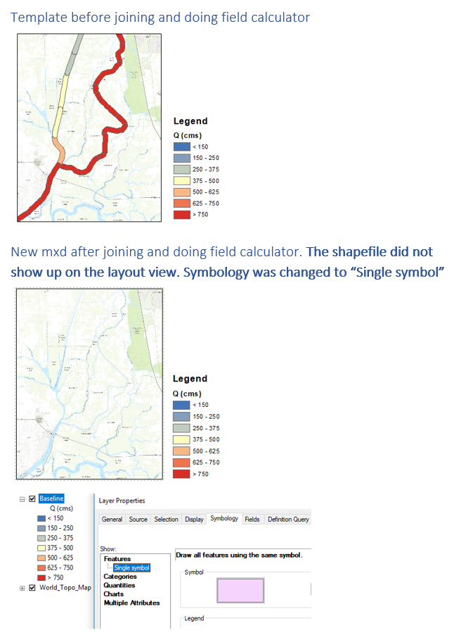

Hello everyone,
I am trying to update a map based on a pre-built template. However, after everything ran successfully (python code below), the shapefile that was updated did not show up on the map. Its symbology was also changed from "Quantities: Graduated colors" to "Features: Single symbol". I'm not sure what I did wrong? Any pointer is appreciated. Thanks!
Before and after calculation
Steps that I did:
  • Read the original shapefile in the template with preset symbology.
  • Copied that shapefile to a new one.
  • Added a csv file then joined it with the newly created shapefile.
  • Updated existing field in the new feature with the values in the csv file.
  • Change the data source from the original shapefile to the new one.
  • Refreshed TOC and ActiveView then exported to a new mxd file.
I opened the new mxd file. The data source is correctly updated to the new file. Values in the attribute table were also correct.

TungNg
Update: I thought the reason was because I did not remove join after performing field calculator. I tried this (after line #43) but the result was still the same
# remove all joins
arcpy.RemoveJoin_management('new_lyr')‍‍‍‍‍‍
TungNg
My current workaround is to duplicate the original folder then do all the calculation on the original shapefile which won't cause any problem
